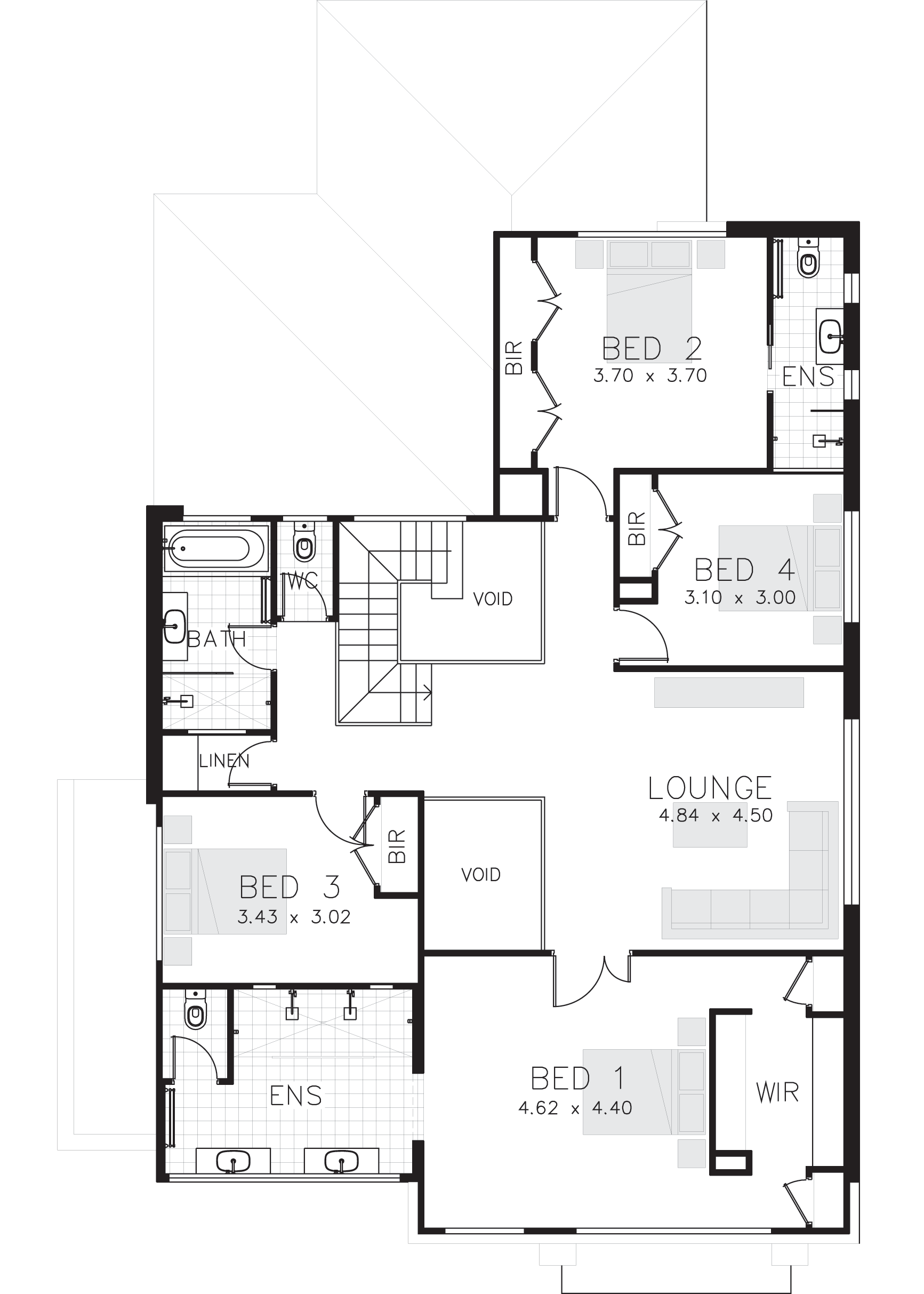

Browse Forums Building A New House Re: Review my Custom Floor plan? [Double Storey, NSW] 8Jan 18, 2020 11:45 am Agreed with amileka, make the void a little smaller to line up with kitchen, you could make a great en suite like in the Rawson Cheilfy 40: https://www.rawsonhomes.com.au/-/media/ ... C82CE89D9C https://www.rawsonhomes.com.au/-/media/ ... 2E16A74C43 Interesting... Built with Eden Brae Now building with Fairmont Homes NSW Re: Review my Custom Floor plan? [Double Storey, NSW] 9Jan 20, 2020 8:59 am amilelka In addition to the other comments I would suggest the following: -move the door for the bottom left upstairs bedroom so that it comes off the main hallway. Otherwise you will have a line of sight from your lounge /entry up to your bedroom door which will reduce privacy. - the void over your dining room doesn't need to be so big. I would line up the void with the edge of the kitchen and allocate the additional space to the master ensuite. Both great ideas. Thank you for your input. I think the moving of the door will be important, because that way I can use that blank wall for a painting or something instead of having a door there. First time builder Double Storey NSW Re: Review my Custom Floor plan? [Double Storey, NSW] 10Jan 20, 2020 9:05 am gogo65 Agree the main bathroom is poorly set out, flip the vanity between shower and bath, otherwise you’ll be walking sideways to get into room. I also agree with amilelka in regards to rear void, i think it would look odd as you have it now, add the space to master ensuite. Also not sure why the laundry doesn’t line up with pantry wall. I’d also try and widen the entry, otherwise its going to look like a tunnel. I really think the design has been compromised in order to inefficient voids... This is an interesting one. I didnt really look into the Main Bathroom. I will move the vanity in between the shower and the bath. Not sure why the laundry isn't lined up to the pantry, I will speak to the person designing the plan Can you please elaborate on which entry you are referring to? The main entry or the entry into the Laundry? First time builder Double Storey NSW Re: Review my Custom Floor plan? [Double Storey, NSW] 11Jan 20, 2020 9:08 am Gildea Agreed with amileka, make the void a little smaller to line up with kitchen, you could make a great en suite like in the Rawson Cheilfy 40: https://www.rawsonhomes.com.au/-/media/ ... C82CE89D9C https://www.rawsonhomes.com.au/-/media/ ... 2E16A74C43 That is a fantastic ensuite, but I don't know if we can achieve that as the one in our draft is a lot narrower. Thank you, First time builder Double Storey NSW Re: Review my Custom Floor plan? [Double Storey, NSW] 12Jan 20, 2020 10:01 pm VENGEANCE gogo65 Agree the main bathroom is poorly set out, flip the vanity between shower and bath, otherwise you’ll be walking sideways to get into room. I also agree with amilelka in regards to rear void, i think it would look odd as you have it now, add the space to master ensuite. Also not sure why the laundry doesn’t line up with pantry wall. I’d also try and widen the entry, otherwise its going to look like a tunnel. I really think the design has been compromised in order to inefficient voids... This is an interesting one. I didnt really look into the Main Bathroom. I will move the vanity in between the shower and the bath. Not sure why the laundry isn't lined up to the pantry, I will speak to the person designing the plan Can you please elaborate on which entry you are referring to? The main entry or the entry into the Laundry? I was talking about the main entry, it’s seems very narrow and long, will be dark. Also in regards to the suggested en-suite change, if you make the void smaller you’ll have plenty of room to make a fantastic en-suite! i thought the flipped plan initially but bec i want narrow pathway from entry to dining (dont like bend), also cannot fit the… 7 17260 Hi, Seeking volume or semi-custom builder in victoria(east), which have existing double story wide floor plans. Seeking 18-20m wide homes with depth of 12-15m long. Or… 0 25159 6 55311 |
