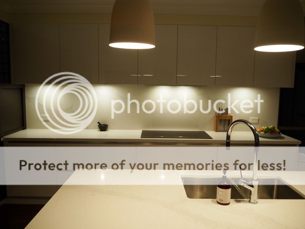

Browse Forums Kitchen Splashbacks 1 Apr 01, 2015 3:16 pm Does anyone have any pics of their completed splashback in stone? Does anyone have any hints or tips about this type of splashback? Re: Spalshback in stone 3Apr 02, 2015 7:49 am YesI have heard that. I had forgotten about that actually. When you say lots of clearance how much? What is the issue does it get too hot? Re: Spalshback in stone 4Apr 02, 2015 2:02 pm The naked flame runs under the pot and scorches the surface if too close. If you are using gas make sure the large burners are at the front or have a deeper benchtop width of 650 -700mm. The Australian Standard for gas cooktops from the splashback is 200mm to the burner Re: Spalshback in stone 6May 25, 2015 2:42 pm Hi Leksie, here is our stone splashback. For reasons mentioned above we went induction cooktop. http://i786.photobucket.com/albums/yy141/sco77k/Done97-g_zpsslyqlpue.jpg Re: Spalshback in stone 7May 25, 2015 9:42 pm That looks great!! Custom downslope build Build thread viewtopic.php?f=31&t=61873 Blog http://www.buildingroyalmanor.blogspot.com.au Re: Spalshback in stone 9Aug 08, 2015 10:08 pm sco77k Hi Leksie, here is our stone splashback. For reasons mentioned above we went induction cooktop. http://i786.photobucket.com/albums/yy141/sco77k/Done97-g_zpsslyqlpue.jpg Very very nice Re: Spalshback in stone 10Aug 09, 2015 2:05 am sco77k Hi Leksie, here is our stone splashback. For reasons mentioned above we went induction cooktop. http://i786.photobucket.com/albums/yy141/sco77k/Done97-g_zpsslyqlpue.jpg I never replied here - thanks. We're definitely getting a stone splashback, or if not stone x-light (a gorgeous very large format 3mm porcelain - the sheets are 3.6 metres long but it's $$!). I love your kitchen, we are looking at Carrera Quartz for our splashback, similar to yours and a pure concrete bench top. We have opted for gas so I do hope the distance is adequate between cooktop and splash.. Dear Members I have to decide the Facade column size. My custom builder standard is 350mm with rendering, but i asked for 470mm plus stone or tiles and yet to get… 0 7508 Hi, planning on using the attached stone pieces in my bathroom. I want to remove stains and gloss seal. Can I get some advice on best way to remove stains and best… 0 6713 Re my second point – yes exactly. And often it may take additional time if the manufacturer recommends no more than X meters… 3 5659 |
