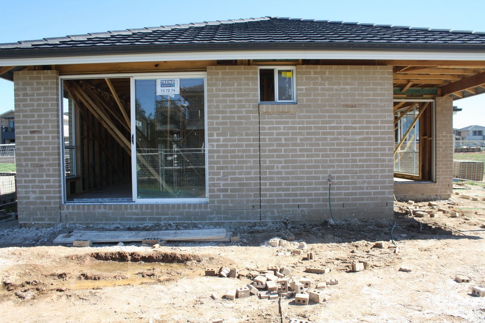

Browse Forums Building A New House 1 Apr 11, 2011 9:54 pm Allworth has finished our bricks today and I noticed there is a gap they have left in the rear wall as shown below. This has some black spongy thermocol like material as the filling. Does anyone know if this is standard and if I should accept this? http://4.bp.blogspot.com/-2EPWJA-NQag/T ... G_4940.JPG It seems like its done on purpose. Can anyone shed light on this? ------------------------------------------------------- http://homeinkalina.blogspot.com Enjoying our new Concerto with Allworth Homes in Kalina, The Ponds Handover - 28/06/2011 Re: Gap between bricks 2Apr 11, 2011 9:55 pm It is an expansion join. Perfectly normal and nothing to worry about. Re: Gap between bricks 3Apr 12, 2011 10:23 am There will be one of those every 5mt in any brick wall. For example the southern facing wall of my new place will have 3 as it is nearly 20 mt long. Re: Gap between bricks 4Apr 12, 2011 11:22 am ...and if you look below the left side of your sliding door, there is one there too! They will fill it eventually with a putty/silicone type stuff that will blend in with the colour of your bricks. Here is one of mine on the front facade (during construction) with the coloured putty...don't even notice it now the house is finished. Like ⋅ Add a comment ⋅ Pin to Ideaboard ⋅ Henley - Wilshire Mk 3 ... I love my house!! Site start: 4th Feb 09 Handover: 10th Sep 09 Blog: http://stormygirlscastle.blogspot.com/ Build Thread: viewtopic.php?t=7166 2 7533 Got my stairs designed like this with 250mm Gap marked below. Gap is bec of 2 steps added between two landing area… 0 4872 This is one of the reasons I decided to go overseas for my double glazed windows. As the builder indicated, he's worked on many upmarket builds, these were the most well… 13 19241 |
