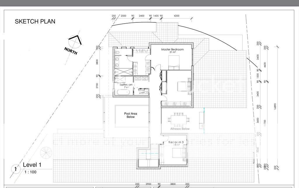

To add another layer of complexity, we are trying to give the granny flat on the north end of the ground floor a bit of a raked ceiling in the living area too. So potentially I will have to narrow the MBR and lengthen it N-W. This in turn may mean we'll just have to bite the bullet and build over the alfresco (was hoping to not have to do this) and not have any gap between br2 and 3. Thinking about it now, this may solve a couple of other issues wrt the stairs and the downstairs "living room" that I have...hmmm...
Also, I like the way that you've addressed solar access with your design, given the orientation of your block! Just avoid the temptation to put too much glass facing west over that swimming pool
The only other concern I can see at the moment is the internal bathroom in the south-west wing - I can see what you're trying to do there, but I'd personally try to get it some external 'wall-age' for a window or two (not just for natural light, but also for ventilation). With the fully internal placement, there might also be some noise issues with your wet wall placement (at the moment it's surrounded by a study nook, bedroom and living area - none of those are ideal to share plumbing noises with). If you're prepared to lose a little of the demi-'ensuite-ness' re the guest bed, placing it closer to the kitchen would (probably) also reduce your plumbing runs.
I was initially worried about the west windows too, in the pool area, but now the idea is to bring the second storey roof all the way down to the single storey west wall of the pool (so my pool will have a raked ceiling too
We designed the pool and alfresco areas as courtyards to primarily get north light onto the back part of the house. But it also has the happy advantage of cross breezes from all directions. And I think it will be rather nice to be able to open both sides of the ground floor corridor completely and combine the pool and alfresco into one large area. I'm quite excited about that!
