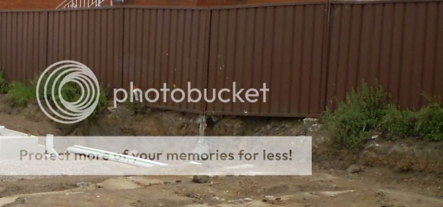

Browse Forums Building A New House 1 Feb 04, 2010 8:25 am Hi all, I'm in the process of building in South Sydney, and after initial excavation one of the side fence footings has been exposed, causing that part of the fence to sag a little. I've been trying to get some quotes on retaining walls but have recently heard mention of something called reinforced shotcrete which is quicker and cheaper than retaining walls? Has anyone else tried this? I'd like to know how happy you were with the end product. I'm not too fussed about it being 'uglier' than a retaining wall. rivercup Re: Shotcrete vs retaining wall 2Feb 04, 2010 8:34 am Shotcrete is pneumatically applied (pressure sprayed) concrete onto a surface which has reinforcement - it's used extensively in commercial construction. I think it's also used in pool construction (but maybe not so much anymore... )...skate parks... I think for a small quantity it would prove too expensive because of the set up costs. You're probably better off on the retaining wall path for domestic applications. Rendered it would look like a normal rendered concrete/brick wall. You need to correct the damage your excavation as caused first...any photos? mmm....donuts Homer Simpson 1956- Links: Site Costs Ready Reckoner | H1 Addiction Medical Advice | Château TDL: The Backyard Re: Shotcrete vs retaining wall 3Feb 04, 2010 8:35 am TDL you beat me by . . that much Hmmm cheaper, possibly... That is how a lot of our pools are being built. The finish is fine when renderd. Where you are coming from is where you are going to... Re: Shotcrete vs retaining wall 4Feb 04, 2010 8:40 am mmm....donuts Homer Simpson 1956- Links: Site Costs Ready Reckoner | H1 Addiction Medical Advice | Château TDL: The Backyard Re: Shotcrete vs retaining wall 5Feb 04, 2010 8:41 am Yep Where you are coming from is where you are going to... Re: Shotcrete vs retaining wall 6Feb 04, 2010 8:47 am Here's a picture of the exposed part of the fence http://i970.photobucket.com/albums/ae181/ragytag/Exposed_footing.jpg Re: Shotcrete vs retaining wall 7Feb 04, 2010 8:51 am I think you were looking ahead of yourself.. Just need to remove part of the fence rebuild the footing and replace the fence. Shot will cost more than the footing just in setup like TDL said. Where you are coming from is where you are going to... Thank you again Simeon.. I will call my certifier for that. Have a good day 4 5188 Thanks for the insights, that makes perfect sense, and yeah, I will be leaning on the experience of the excavator operator entirely. 6 16147 Hi All, I engaged a tradie to install concrete retaining wall 600-800mm high over 32 meters in Victoria. Sleepers are 200*75*2000 mm installed over 17 steel posts. I… 0 6917 |
