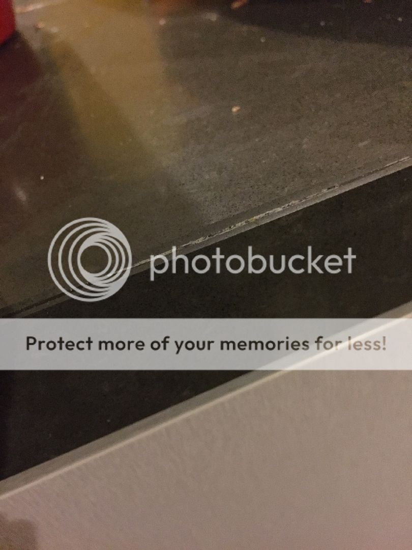

Browse Forums Kitchen Corner 1 Apr 29, 2015 10:34 pm Hi all! Just wondering if you could tell me if this is normal (I hope not) and if it can be fixed (I hope so lol) These white marks are along the joins on some spots of our island bench. Because it's a dark bench they're very noticeable. http://i1327.photobucket.com/albums/u661/mrst12/259C69FA-960A-4FCF-9372-7A18C25AC0C9_zpsb2dfjxk7.jpg (Excuse my dirty bench, I was cooking when I took the pic lol) And is this something the builders will/can fix at our 12mth inspection? Thanks! Re: Caesarstone edge marks 2Apr 30, 2015 8:20 am I looks like you have mitred 40mm stone?? It looks from that photo that the mitre has opened up or wasn't done well in the first place. They will try and fix it by putting some filler in there. Just make sure its the right colour and done well. Cutting Edge Kitchens and Cabinet Making http://cuttingedgekitchens.net.au http://www.facebook.com/pages/Cutting-Edge-Kitchens/290484196676 Mobile : 0419 430 575 PH: 9452 4772 Fax :9452 4772 cuttingedgekitchens@outlook.com Re: Caesarstone edge marks 3Apr 30, 2015 10:57 am As CEK said, it seems your mitre has either come apart or the filler has just fallen out of the join. It should be a relatively simple fix for your builder, just ensure the correct colour is used and the repair is carried out correctly. Caesarstone carry a range of colour-matched adhesives so if you aren't happy with their colour match you can request that they use our branded products for a perfect match. Re: Caesarstone edge marks 4May 03, 2015 11:01 pm CaesarstoneAU As CEK said, it seems your mitre has either come apart or the filler has just fallen out of the join. It should be a relatively simple fix for your builder, just ensure the correct colour is used and the repair is carried out correctly. Caesarstone carry a range of colour-matched adhesives so if you aren't happy with their colour match you can request that they use our branded products for a perfect match. Do Caesarstone do custom drain ridges beside sinks. I saw it on the website. How much does it cost? Is it good enough to run water off beside the sink?? Re: Caesarstone edge marks 5May 04, 2015 8:22 am Do Caesarstone do custom drain ridges beside sinks. I saw it on the website. How much does it cost? Is it good enough to run water off beside the sink?? [/quote] No Caesarstone don't do the drainer grooves. They are only a material supplier. Yes the stone mason that will cut and supply the Caesarstone drainer grooves. Have a look below at the google images of them. Price is dependant on the size and number of grooves. https://www.google.com.au/search?q=caes ... d=0CC4QsAQ Cutting Edge Kitchens and Cabinet Making http://cuttingedgekitchens.net.au http://www.facebook.com/pages/Cutting-Edge-Kitchens/290484196676 Mobile : 0419 430 575 PH: 9452 4772 Fax :9452 4772 cuttingedgekitchens@outlook.com Hi All, We are building in Maitland and considering between Vision Homes or New Edge Homes (part of Masterton). Anyone has experience with them especially in Maitland -… 0 3164 Hello everyone, After some suggestions and ideas about how to put a concrete path around the drop edge beam area on our new build. We are required to have a concrete path… 0 11006 |
