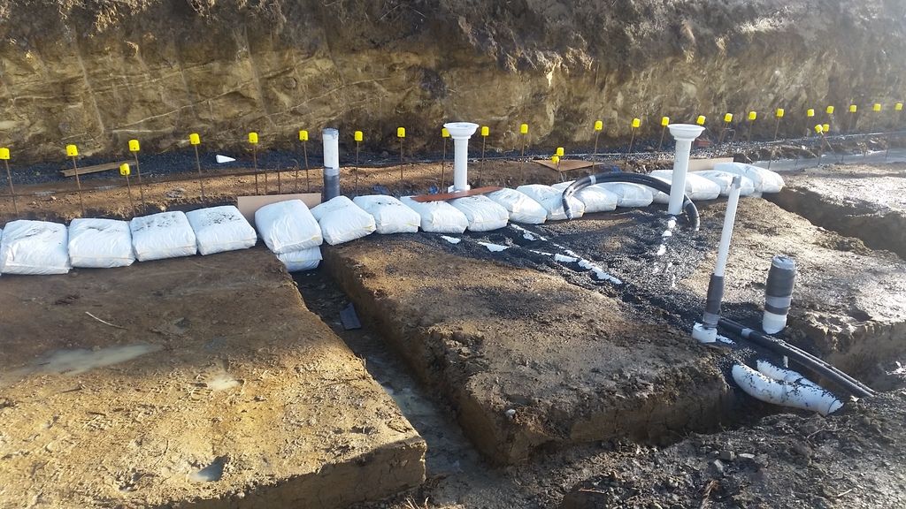

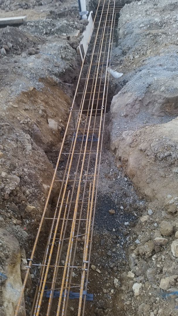

Browse Forums Building A New House Re: Custom Build - Tolmans Hill, Tasmania. 21Jul 05, 2015 8:27 pm Ilaeria Gorgeous view in a great area! We used to live up Mount Nelson, I love Hobart, it's beautiful It is a lovely spot. Just enough away from the city! bluesteel That is a great view. And I second that it feels like an episode of Grand Design!!! It's fantastic. Re: Custom Build - Tolmans Hill, Tasmania. 22Jul 24, 2015 8:01 pm Its been a busy couple of weeks on site. Slab was poured today, beautiful weather for it. No issues so far other than a couple of very cold day for the boys up there. Pics will do the talking Trench mesh in http://i1122.photobucket.com/albums/l526/Brendan_Sumpton/20150710_162520_zpsyzx9qmgp.jpg Plumbing in, bags of our under slab insulation (Clinkafill) in bags ready to go) http://i1122.photobucket.com/albums/l526/Brendan_Sumpton/20150717_135919_zpsodj9ikzv.jpg The under slab insulation close up - expanded clay, all the way from Denmark! Helps give the slab an R rating of 1.2. http://i1122.photobucket.com/albums/l526/Brendan_Sumpton/20150717_140040_zpsdj3bzvnw.jpg Clinkafill under black plastic, footing reo folded over and connected to slab reo. Outer edge of slab is insulated with 1/2 ClinkaBlok - another way to ensure the slabs R1.2 rating, and easy way to box up. http://i1122.photobucket.com/albums/l526/Brendan_Sumpton/20150722_163000_zpsxo3cwwud.jpg Full view http://i1122.photobucket.com/albums/l526/Brendan_Sumpton/20150722_163051_zpsclyfh3d9.jpg Slab done - note notch in foreground for garage door. Hoping to get an insulated garage door as we have moved the laundry from the downstairs bedroom, to a cupboard in the garage. Having it insulated will help keep this area more pleasant. http://i1122.photobucket.com/albums/l526/Brendan_Sumpton/20150724_154717_zpshft5byhl.jpg Ground floor level. The drop to the road is a little steeper than we had planned, I am unsure if this will be a problem with council/surveyor, but hopefully not. http://i1122.photobucket.com/albums/l526/Brendan_Sumpton/20150724_154734_zpsfqcs1smn.jpg Boxed for downstairs shower, which will be glass panels straight onto tile base. http://i1122.photobucket.com/albums/l526/Brendan_Sumpton/20150724_154739_zpspn4x6d3n.jpg http://i1122.photobucket.com/albums/l526/Brendan_Sumpton/20150724_154750_zpsuo14n7co.jpg The ClinkaBlok brick http://i1122.photobucket.com/albums/l526/Brendan_Sumpton/20150708_162921_zpsmyt8llry.jpg That is all the pics for now. I have finalised getting the power hooked up which should be on next week. Our brickie has broken his finger so the builders will be doing the bricking until he is good to go again. The bricks are very simple and the rep has been up to give a thorough run down and will be popping up periodically to ensure all is well. Next up is lower floor bricks and stud framing! Stay tuned Re: Custom Build - Tolmans Hill, Tasmania. 23Jul 24, 2015 8:51 pm Congrats on getting your slab, very exciting indeed. What facinating under slab insulation, looks like coffee beans oh and that view My build thread: Custom build on 40 acres viewtopic.php?f=31&t=75656 Re: Custom Build - Tolmans Hill, Tasmania. 24Jul 25, 2015 8:00 pm Congratulations to your slab!! Well done! Live Love Lough Building thread: https://forum.homeone.com.au/viewtopic.php?f=31&t=74918 Building blog: http://uniquebyeva.com.au/ourhome/ Our food forest blog: http://www.foodforestcookery.com Re: Custom Build - Tolmans Hill, Tasmania. 25Sep 02, 2015 11:15 am Update: Things have been moving quite good on site. BRICKS: Looks as though the brickie didn't break has finger he just didn't want to work with our bricks. Some people are just stuck in their ways. All good though as the builders did it themselves, did a great job and saved a few bob as well. Boys onsite http://i1122.photobucket.com/albums/l526/Brendan_Sumpton/20150731_150255_zpstkit5lt7.jpg Motar insulation between each layer http://i1122.photobucket.com/albums/l526/Brendan_Sumpton/20150814_144926_zps53s4hh5u.jpg http://i1122.photobucket.com/albums/l526/Brendan_Sumpton/20150814_150656_zpsawlhef35.jpg Nearly done. Steel tie rods are installed at all wall ends, these are embedded into the slab, then the bricks are slid over the top, and tied into the concrete in the top course. http://i1122.photobucket.com/albums/l526/Brendan_Sumpton/20150819_170848_zpsire1xqsq.jpg Temporary posts on the LHS for when the steel gets delivered. http://i1122.photobucket.com/albums/l526/Brendan_Sumpton/20150819_171050_zpsyzpkjgr4.jpg STEEL: Steel is up and in place, a few very snowy days saw the whole block coated in snow and the road shut to get up there which delayed this getting completed. There are a few beams in the middle of the deck area (cantilever area) that need to be changed as they were hanging too low, which would impact the underside of the deck. Snow on site! Tassie just had its coldest winter in 50 years. Drove footage of Tolmans Hill in snow https://vimeo.com/135202073?outro=1 Steel delivered! Big milestone! http://i1122.photobucket.com/albums/l526/Brendan_Sumpton/20150822_100744_zpsp9mqohto.jpg Cantilever - the steel support beams will be removed once fullly welded/bolted http://i1122.photobucket.com/albums/l526/Brendan_Sumpton/20150822_101250_zpseefg8lzu.jpg http://i1122.photobucket.com/albums/l526/Brendan_Sumpton/20150822_101300_zpsxhitbclf.jpg That is all so far. Next up: - Framing down stairs - remove supports from brick lintels - temp stairs to upper floor - redo support beams on deck - floor joists in - floor on Questions/comments welcomed Re: Custom Build - Tolmans Hill, Tasmania. 26Sep 02, 2015 11:59 am I'll say it again... Oh my check out that view. What an interesting build, can't wait to follow. Re: Custom Build - Tolmans Hill, Tasmania. 27Sep 02, 2015 12:51 pm Looks fantastic and love the view! I can't believe you guys had snow down there! Jen (& Dave) Plantation Bronte, Ormeau Ridge, Gold Coast QLD 12/03/2015 - Commencement... 26/08/2015 - Handover! viewtopic.php?f=31&t=76446 Re: Custom Build - Tolmans Hill, Tasmania. 28Sep 03, 2015 10:06 pm Exciting progress, what a beautiful video of the area, the snow looked magical. My build thread: Custom build on 40 acres viewtopic.php?f=31&t=75656 Re: Custom Build - Tolmans Hill, Tasmania. 29Apr 05, 2016 2:50 pm So very sorry for the lack of updates, life has been a bit crazy. I was moved up the north of the state for work.....yes I am serious. I have to be up here for minimum 2 years, so I will be travelling (2hrs) quite a bit during days off. The house is nearly finished, but I will let the pictures to the talking. If anyone has any questions about any stage/item/image you see, just let me know. http://i1122.photobucket.com/albums/l526/Brendan_Sumpton/IMG_20150725_101050_zpssfof6eql.jpg http://i1122.photobucket.com/albums/l526/Brendan_Sumpton/IMG_20150918_170310_zps9nksti83.jpg http://i1122.photobucket.com/albums/l526/Brendan_Sumpton/IMG_20150822_170826_zpssbka32kn.jpghttp://i1122.photobucket.com/albums/l526/Brendan_Sumpton/IMG_20150919_190719_zpsc96vjjqt.jpg http://i1122.photobucket.com/albums/l526/Brendan_Sumpton/20150911_142758_zpsmds35dos.jpg http://i1122.photobucket.com/albums/l526/Brendan_Sumpton/20150923_160430_zpsxstlgevz.jpg http://i1122.photobucket.com/albums/l526/Brendan_Sumpton/20151018_115403_zpsduitxmt9.jpg http://i1122.photobucket.com/albums/l526/Brendan_Sumpton/20151018_121817_zpsudtgwa0s.jpg http://i1122.photobucket.com/albums/l526/Brendan_Sumpton/20151021_160342_zpsi2og0irw.jpg Re: Custom Build - Tolmans Hill, Tasmania. 30Apr 05, 2016 2:55 pm Continued http://i1122.photobucket.com/albums/l526/Brendan_Sumpton/20151030_123849_zpsnghgep7p.jpg http://i1122.photobucket.com/albums/l526/Brendan_Sumpton/20151113_142022_zps8srbo8st.jpg http://i1122.photobucket.com/albums/l526/Brendan_Sumpton/20151121_150932_zpsxqanxa3l.jpg http://i1122.photobucket.com/albums/l526/Brendan_Sumpton/20151211_143924_zpshzv0qmth.jpg http://i1122.photobucket.com/albums/l526/Brendan_Sumpton/20151211_144110_zpsfzqififp.jpg http://i1122.photobucket.com/albums/l526/Brendan_Sumpton/20151225_173224_zps7fovgzko.jpg http://i1122.photobucket.com/albums/l526/Brendan_Sumpton/20151225_173729_zpspn0mdf0h.jpg http://i1122.photobucket.com/albums/l526/Brendan_Sumpton/20151227_113341_zps55llzyft.jpg http://i1122.photobucket.com/albums/l526/Brendan_Sumpton/20151227_121053_zps6eirpxwq.jpg http://i1122.photobucket.com/albums/l526/Brendan_Sumpton/20151227_121238_zpsvbgvzxze.jpg Re: Custom Build - Tolmans Hill, Tasmania. 31Apr 05, 2016 3:02 pm Continued http://i1122.photobucket.com/albums/l526/Brendan_Sumpton/20160115_113032_zps97yu4amy.jpg http://i1122.photobucket.com/albums/l526/Brendan_Sumpton/20160227_095429_zpsiwyrow40.jpg http://i1122.photobucket.com/albums/l526/Brendan_Sumpton/20160227_095652_zps06cwtfwx.jpg http://i1122.photobucket.com/albums/l526/Brendan_Sumpton/20160227_095931_zpsxwmcbobk.jpg http://i1122.photobucket.com/albums/l526/Brendan_Sumpton/20160227_095949_zpsy9aqgrg3.jpg http://i1122.photobucket.com/albums/l526/Brendan_Sumpton/20160302_145717_zpsh45swibs.jpg http://i1122.photobucket.com/albums/l526/Brendan_Sumpton/20160302_150939_zpsgtricwbu.jpg http://i1122.photobucket.com/albums/l526/Brendan_Sumpton/20160302_151021_zpsiabisghy.jpg http://i1122.photobucket.com/albums/l526/Brendan_Sumpton/20160305_121201_zpsdt2lpoz0.jpg http://i1122.photobucket.com/albums/l526/Brendan_Sumpton/20160305_121207_zpsf5qkzij8.jpg http://i1122.photobucket.com/albums/l526/Brendan_Sumpton/20160305_121226_zps3kohwuut.jpg Re: Custom Build - Tolmans Hill, Tasmania. 32Apr 05, 2016 3:16 pm Continued http://i1122.photobucket.com/albums/l526/Brendan_Sumpton/20160305_121716_zpsuemtgs36.jpg http://i1122.photobucket.com/albums/l526/Brendan_Sumpton/20160325_124720_zpsdj209em4.jpg http://i1122.photobucket.com/albums/l526/Brendan_Sumpton/20160325_125450_zpsr1tei5ho.jpg http://i1122.photobucket.com/albums/l526/Brendan_Sumpton/20160325_125510_zps9p6hysyi.jpg http://i1122.photobucket.com/albums/l526/Brendan_Sumpton/20160325_131153_zpsr6zv4p93.jpg http://i1122.photobucket.com/albums/l526/Brendan_Sumpton/IMG_20160404_193508_zps8quhdvuh.jpg And that's where we are at currently. The tiler is in today finishing off the bathrooms.The plumber can then finish off. We have had some issues with the kitchen benchtops. We have 700mm tops, not the standard 600mm. The joiner has quoted at 600mm and did not resend through an invoice after he came for a check measure. Its going to cost us a bit extra now ($3000!) Thats all for now. Re: Custom Build - Tolmans Hill, Tasmania. BIG UPDATE - PICS 33Apr 05, 2016 6:08 pm Wow your house looks amazing! What a stunning view, thanks for the update, would love to see the finished pics. Must be hard to work away from that! Custom build Northern NSW viewtopic.php?f=31&t=72217 Re: Custom Build - Tolmans Hill, Tasmania. BIG UPDATE - PICS 34Apr 05, 2016 6:24 pm I grew up on Mt Nelson so exciting to see this build on here. The house looks crazy amazing! Re: Custom Build - Tolmans Hill, Tasmania. BIG UPDATE - PICS 35Apr 05, 2016 9:46 pm Sooooo very cool. Looks like it should have been on Grand Designs Oz. That view is just amazing Re: Custom Build - Tolmans Hill, Tasmania. BIG UPDATE - PICS 36Apr 05, 2016 10:54 pm OMG amazing! !! And the view.. Perfection ! _________________________ Building the Noosa 26 with Coral Homes https://forum.homeone.com.au/viewtopic.php?f=31&t=80794 Howdy all. I am looking for feedback on what people would do to maximise and make an area as flat as possible. First, out the front of the house is a sloping hill, pretty… 0 20675 I brought terry road box hill in June 2022 House was meant to be completed Nov 2023 That did not happen I had to chase them so much to the land Registration and… 0 2854 I'd get the gutters to match your roof and pipes to match the paint - otherwise they become a feature. Nice pick with the paint colours! 1 34839 |
